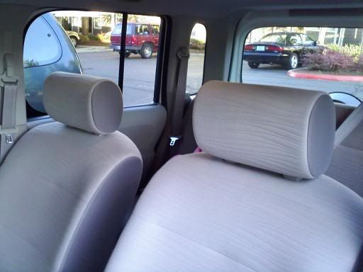

Anyone know if there are any headrest tvs yet for the cube? and why dont they go all the way down? i hate that......

and i just cut the posts of my headrest so they sit flush with the seat now.. no more gap...

The front headrests move forward to minimize neck injury during a rear-end impact. I would not want to do anything that could compromise that safety feature.

Actually if you read up on Nissan's active headrest it doesn't help in a front end collision and wasn't designed for that purpose. It's sole purpose is to protect from neck and back injuries in a rear end collision (the airbag is for front end collisions). The force of a front-seat occupant on the seatback is used to activate the system, moving the head restraint forward immediately to firmly support the occupant's head and mitigate the impact to the neck region.
The way it works is that your body pushes back into the seat when you're hit from the rear, this action pushes back on the headrest posts causing the headrest to pivot forward at the top where the posts enter the seat back.
Cutting off a small bit of the posts to allow the headrest to sit flush would probably not prevent this from occuring. It wouldn't alter the pivot point but it would lessen the headrest's forward travel a bit simply because the head rest sits lower. But I don't think it would become ineffective, maybe a little less effective.
But even at that, it's effectiveness isn't just based on it's forward travel in an impact. It's also dependant on the passengers height in the seat. Like anything safety related, what works for a tall person may not work for a short person and vise verse. - Dan

Oh, I couldn't agree with you more on the value of headrests in general. I think they can and do help prevent serious head and neck injury and only a fool would remove them. But I think this thread was started because someone wanted to modify their's to sit flush with the top of the seat back and at some point the Active headrest came in to play. My point wasn't to dispute weather or not they help protect in frontal or rear end collisions, only to point out that modifying them to sit flush would more than likely not cause them to become ineffective. - Dan

No problem, Dude :)! However, I would have one other concern if a person shortens the head rest posts with the specific purpose of having them sit flush to the seat backs. If this results in the head rest contacting their head below its center of mass, then they are actually defeating the purpose of the head rest (ie. they're raising their risk of neck injury in a frontal or rear collision). In fact, if that is the situation, then the "active" function will actually exacerbate the problem, rather than help solve it. If the headrest moves forward pushing below the heads center of mass, it will have the effect of both lifting and tilting the head backward -- making the situation distinctly worse.
