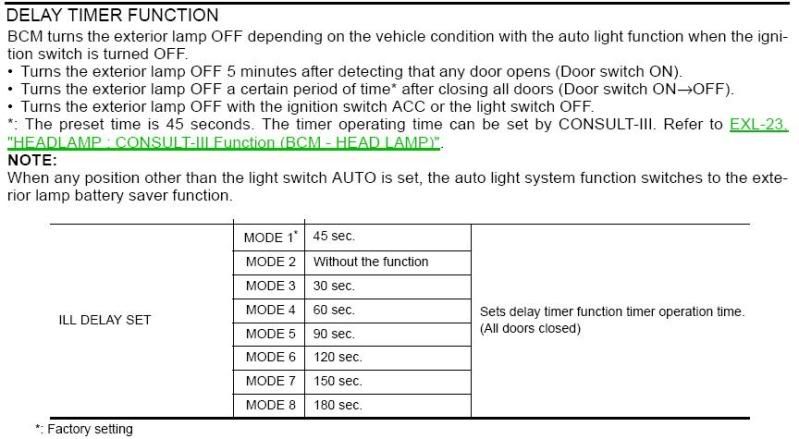

i found it in the service manual!
here's a clip:
what is a "CONSULT - III"?
tbone13 said:
MDracer76 said:
Your owners manual has the answers
here's a clip:
Where in the manual did you find it? Page so we can all follow along.
the image is a hack job from 2 pages..
the first text portion is on EXL page 13
and the chart is on EXL page 23.
i updated the pic with the correct text.
